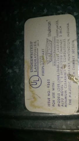

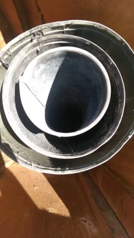

I have some majestic triple wall pipe and I'm just trying to make sure it qualifies as a class A chimney system I don't know how old it is but Included a picture of the label on the pipe.

Looks like it's air cooled pipe. I am going to guess it is not qualified as class A.
No, that is not class A pipe. It's triple wall pipe for a fireplace.
It's not tested or approved for wood stoves. If it was it would be listed as "HT" for high temperature.
