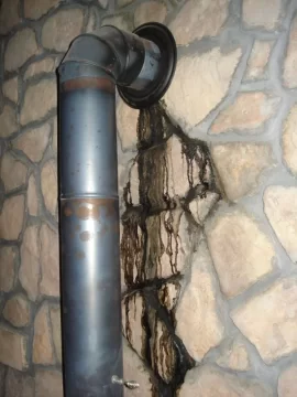

I have a brick chimney lined with 8" liner that is approximately 25' total distance from thimble to cap. I am having problems with condensation pouring out of the thimble. It is definitely related to outdoor temperature & the temp of the stove. I have yet to find the exact point at which it occurs but I know that when the stove is less than full output it usually happens especially if it's colder outside. (<25 degrees) My question is if it would be a problem to drill 1" hole to the bottom of the liner and route that condensation to a dry well filled with gravel? I am a builder and have the tools for this kind of fix but I'm not sure if this is the best idea or someone might have a better fix. As you can see this is working wonders for the decorative stone I laid behind the stove. The house is only 3 years old and I had the liner cleaned 3 weeks ago. He said it looked great. By the way, the stove is a Vermont Defiant. Any advice is appreciated.
  • [Hearth.com] Major condensation problems.  Quick question.
do you have a cleanout at the bottom of your metal chimney ?
if not, it looks to me that the cresosote condensation is actually building up in your chimney..several inchs or feet and then escaping the only place it can...at your connection..
I have the same problem with massive condensation, but I have a spring loaded trap door at the bottom of my steel chimney, that allows me to let all that gook out so it doesnt build up to where my stovepipe meets my chimney connection.
Actually I don't have a cleanout on this chimney. The thimble is in my basement and below grade so there really was no way to install an exterior access point. I also didn't think this type of install (wood stove only) would require one since I have my liner cleaned yearly by my chimney sub. Apparently I was VERY wrong.
A couple of thoughts. Is your 8" liner pipe and insulation or is it just a stainless liner. If just stainless than insulating the pipe will go a long way towards limiting the creosote. I think the hole at the bottom of the pipe is a bad idea. It will possibly let water out but it for sure will bring in air to make your chimney even more of a creosote machine.
What was in this chimney before you installed the pipe? This could be creosote left over because the chimney was not cleaned properly before installation. The new pipe is heating the old chimney and you have a condensation problem. Perhaps you could look down the old chimney and see if there is any creosote?
You should also check the top plate to be sure no water is getting in. Sometimes a good looking plate will not be sealed well.
Well there are some ideas good luck.
Not sure from the pic if you have a clay thimble running into your chimney.
If you do & you have a masonry adapter inside that, you need to run the masonry
adapter father into the chimney...
If you can get the adapter pipe AT LEAST 1" min into the terra cotta flue tile,
the creosote will run down INSIDE the flue instead of inside the house...
I had the exact same problems you have and the only fix was to reline the chimney with a 5.5" flex liner. Condensation is occurring because your tiles have shifted or cracked. No matter what I did I could not stop the leaking like you show until a liner was installed. Since the liner has been in place I have not had a hint of moisture from the chimney.
Your condition is the perfect storm for a chimney fire as I had one after mine kept doing what yours is. I went to the trouble to seal my pipe into the tile liner really good to where the liquid would run into the stove and not onto the wall and shortly after the chimney fire took place.
It is a tile thimble to tile liner application. That stove pipe actually runs through the thimble 16" or more (12" CMU block & chimney block surrounding flue tile). I have non-flammable insulation filling the small void between the stove pipe & thimble walls to prevent air bypass.
Exactly as same as mine was. Pipe was at least 12'+ into the thimble. Now it is a flex liner all the way to the stove. I suspect something bad went wrong with a tile somewhere just as it did with ours.

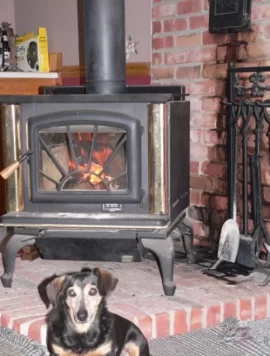

How about a pic of the stove :)
And maybe a pic of the chimney outside?

Looks familiar. What size is your stove pipe? Is it 8" also? I had the same problem. The goop was more water than creosote. I put in a 6" SS liner which was the same dimension as the stove pipe and my problems ended. I also am burning better wood this winter.

runme, the two things I would check are first to be sure there is no air leaking into the flue from the cleanout door. Duct tape it on all seams and the hinge temporarily to check. The other thing I would do is not close the air all the way. Don't close it further than where the factory stop was before it was removed. That will keep the flue hotter.
Bob B. You need to get things warmer assuming that this is not a case of partially seasoned wood. Double wall pipe on the interior connector would help a bit. Burning a bit hotter might also help.
chimney block construction is just about the worst thing you can use. No clean out=wrong, dead head chimney=wrong, thimble pitched toward living area=wrong. Sounds like you should tear it out and start over.
I assume it's an old Defiant, if so that is a very large heater, needs about 2-2500 sq ft for where you live. Sounds like this is in a basement, stv is probably running way too cool with less than seasoned wood, hence the water content. You may have to look at replacing the stove with a smaller EPA approved model.
Liquid creosote like in your pics has 96 chemical compounds in it and is classified as a hazard waste in several states, this is a health issue for anyone living in the house.
If your chimney pro came out and cleaned the flue, saw the wall and said all is well......you may want to replace him also.
Nighbor had a condensation problem with his wood boiler that led to a chimney fire. Seems to me somehow your gasses are cooling in your run as others have suggested. His solution- stainless steel pipe with insulation.
Sorry to hear about your issues, especially with a new chimney. I think it's going to take a bit of work to fix the issues. Minimum you should get a cleanout installed (interior). Honestly I think the best thing to do if you can is to install an insulated stainless liner. Tile liners are often cold and leaky. The idea with the stainless is to keep the flue gases as warm as possible and get them up and out quickly.
Do as BeGreen suggested. Burn hotter if you can. This will help.
cmonSTART and BeGreen offer sage advice. Reducing the moisture content of wood would only reduce the amount of condensate. After all, 20% MC in a hundred pounds of wood is still 20 pounds of water.
Another, although lesser source of moisture is room air. This can manifest more where people store lots of wood indoors to dry. If the stove is provisioned for an outside air option, drawing dry outdoor air can reduce condensate as well. Moisture is the scaffold upon which creosote can build like snowflakes.
