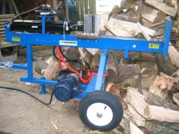

Finally arrived right before Memorial Day weekend. This is the Ramsplitter 20 ton horiz/vert splitter with the 3 hp electric "engine" I wanted a beefy splitter run by electricity and after looking at the Ryobi, Northern Tool, etc. I decided on this one. It can be converted back to gas by just bolting up a new engine.
I have been begging firewood off the local tree guys and never know what will show up. In the past, I have had some really gnarly stuff that gave "The Crusher" a workout. Crusher is a homemade splitter I used to borrow that was (over)built by a bored aircraft mechanic. He always wanted it right back, and I could understand, so I decided it was time for my own. Crusher came with hearing protection standard and had a 16 hp engine that we could stall out if the going got too tough. I'm fairly certain I would have been disappointed in a 6 ton model.

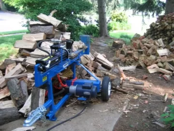

Anyway, I put it together in the garage and connected it up to the breaker panel there. I wanted to fill it up with oil and just try it out. I didn't have anything bigger, so I wired it to a 15 amp double pole (240V) breaker. Pow, blew that one instantly. Thought: Hmm, might be wired for 120V, so I rewired it in the panel and turned it on. It started and ran well with no load on it. I just wanted to fill it with oil and move it back to the patio. Took a closer look and realized the motor is only rated for 208/230V. Hmm. Where's that motor quick reference chart? 3 hp, 1 phase 240V needs a 30 amp breaker and a 50 amp receptacle on #10 wire.
Back on the patio, I ran a chunk of 10 ga Romex straight into my entrance panel and installed a 30 amp breaker. Keep in mind this motor is only rated for 13 FLA at 240V and has a 1.0 service factor. I checked the motor wiring, just a piece of 10 ga rubber cord going into the motor with a manual reset motor overload, no power switch or plug. Coupla (temporary) wire nuts and throw the switch. Started right up. Ammeter (not included) shows about 7 amps in neutral, inrush was 65 amps. Grabbed a piece of wood and started to go to town. Watching the meter showed about 13 amps with occasional spikes to 19-20 amps. The splitter worked great! No problem handling some box elder that was laying around. Kinda worried about that 20 amp number, but it didn't seem to have a problem. I ran it for about an hour and shut it down. Motor temperature seemed OK and it never overloaded to the point of stalling the motor. The relief valve popped before it got that bad.
Finally, the acid test. Don't ask me why, but I unintentionally waited till it was about 95 degrees out and I just had to get that wood split (it's June after all). I ran it straight for over an hour and threw some of the nastiest wood I had at it. Gnarly (it's a subspecies of locust, I think) doesn't begin to describe some of the knots I ran into. Oak, locust, maple all cut about a year ago. The resulting pics are the result. There were a few pieces it couldn't do without backing up and repositioning and one piece of maple just embedded itself on the wedge and smiled at me. After I got that chunk apart, it was one of the worst knots that had been sawn into a very nice block. The grain went everywere, but I got it apart without having to resort to the chain saw.
After that hour, I was a wreck, but the splitter was great. Nothing bent or broke, no leaks and the motor was only 160 degrees. It never stalled the motor or popped any overloads or breakers. Sorry the pictures show the splitter half buried in wood, but you get the idea of what it looks like. Overall, very pleased with it. It is much quieter than a gas engine (think commercial trash compactor loud) and doesn't seem to be lacking for power.

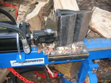

How does the construction look? I have looked at the Ram splitter on the website (cuz I'm too lazy to drive down the street to the factory, its just a few blocks away from where I work). I have always questioned some of the design. Does it seem to be built bullet proof?
I am not picking on it, but it seems that a T beam would not have the strength of an H or I. Just honest questions to a REAL owner of one.

I'm not sure it's bullet PROOF, but bullet RESISTANT would be a good description. The main beam is actually a box section with a plate welded on for the wedge. It even has brass wear strips for the wedge to ride on. The foot as well as the cylinder mount is a piece of 1" steel. I don't think I'm going to be able to bend it. All the welds look pretty heavy to my untrained eye. After a couple of hours of use, it still has all its paint, and I didn't bend or break anything. The cylinder has a clevis mount like a tractor cylinder (easy to service) and the front of the cylinder is held down by a U bolt. I did notice some movement of the cylinder as it loaded up, but I'm not sure this is a problem. Some compliance might be a good thing to keep wear down on the cylinder bushing. They claim their better models are commercial duty and suitable for rental use. Having no rental experience, I can't comment, but I have broken a few MTDs in my day. Definitely no comparison there.

I was playing with it in the vertical mode today on some big pieces. Still very happy with it. I measured about a 1/4" deflection in the main beam (as far as I could measure) at full pressure buried in a knot. There are a FEW pieces that won't break up first try, but NOTHING that hasn't eventually given up. "Crusher" might have been better at it than the Ram, but not much.

Everything that I can see looks good to me. The welding is better than I used to manage , and is continuous, no skip welds. The beam is a box beam with a 3/8" inch plate which does not spring at all, even when I force the ram into relief pressures. The pump does "downshift", into the high pressure mode frequently when I use the four way ram (which is most of the time).
