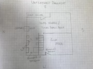

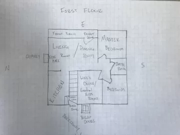

The backdoor leads to a small landing and down the steps to the basement, or up two steps to the left and into the kitchen. There is not a basement door at the top of the steps, just a back entrance door. Meaning air can flow freely. I hope these are not overly confusing, thank you!

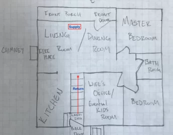

That helps. If I have this correct, the basement stairs unfortunately are not oriented the best for supply convection. It explains why, along with the uninsulated walls, the pellet stove was not as effective as hoped for.
For basement heating it looks like a large fire-dampered supply floor register in the LR would be needed to aid circulation with the stairs acting as the return.
That is correct, the stairs are not oriented properly... at least for heating purposes! Your depiction makes a ton of sense, thank you very much!
