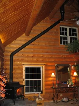

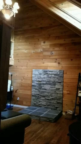

We have picked out the Hearthstone Manchester and are just waiting on the install. Well, the stove company came out and installed the hearth and wall "art" and now I have questions about the way I should/can have the pipe exit the stove and subsequently then the ceiling.
When the stove installers came out for the initial quote, I was told that we could take the double wall pipe out of the top of the stove about 8 ft, 45 it, take it over another 6 ft or so on an angle up (following the dormer ceiling line), 45 once more and then go straight out the ceiling. Now, all this being said, I know that any time you add angled pipe, you run the chance of causing draft issues. However, I would rather not have to run it straight up from this location, as this is on the front of our house and would probably have to be quite tall to get it past the peak of the roof like I understand that it needs to be.
Should I a) get over the fact that it needs to go straight up and hope that it does not become our focal point outside our b) move forward with the double 45s and hope that the runs allow for enough draft?

What a smart looking hearth! Oh and since I have owned that model in the past you certainly should be very happy as I was with it. Awesome stove. I own the Progress now. Always a compromise between techno and aesthetic. I'm usually inside my house and don't care what the neighbors think. I'm a straight up guy as much as possible and proud to show my stack.
It looks like there will be a fair amount of rise to the flue system. If it's over 18 ft total then I wouldn't worry too much about it having the 45's. Just be sure the diagonal run is no closer than 9" to the ceiling, well supported and screwed together at each joint.

Straight up is definitely better. The long run is going to cool down the flue gases a lot. Double wall stove pipe doesn't insulate like chimney does. That said, we've seen it here before.

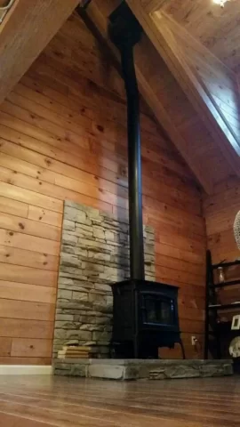

@begreen - The installers are here and seem to be stumped on how to brace the flue and keep it 9" away from the ceiling. Any ideas that I can give them? If I take it straight up, they aren't going to have much to strap it to because of the dormer on the front of the house, so the angled approach might be the only way.
I like it but I don't have one. I've read a lot of the comments lately from owners that haven't had any problems, and really like it. I think they may have ironed out a few problems they had with the early production runs. Customer service is another question but I do my own work for the most part so that wouldn't affect me as much. Looking forward to your updates! ==c
Well, the stove is on the hearth, so we're making progress :) They are going to fabricate some longer brackets made out of the brackets shown below and attach them to the back wall. This seem okay? Hopefully these will work for keeping everything sturdy.

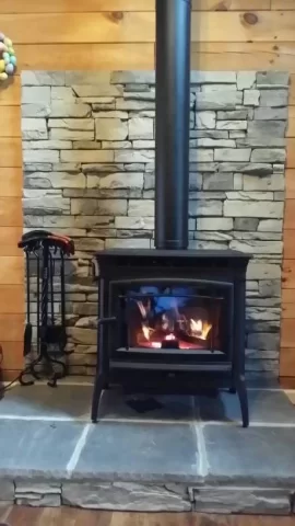

Well, I often wondered if we would get here, but it seems as though the day for her maiden voyage has finally come. Now for the recommendations on breaking in our Manchester. I've read the manual and I don't see where it goes into detail on first burn do's and don'ts. Does anyone know of official first fire guidelines for this stove? I want to make sure I follow something if it exists.
[Hearth.com] Manchester Install Questions
Looking Good! For breaking in I like to burn a small kindling fire first, just a few sticks and let it burn out and the stove cool down. Then for the second fire add a few small 2-3" stick on the kindling. Let the fire burn out and the stove cool down. For the third fire add 2-3 four inch splits to take the stove top up to about 400F. Then for the last break-in fire load the stove at least half full for the paint break-in fire and take the stove up to 500-600F. Be sure to have some windows open for the last fire and maybe a fan pointing out to exhaust fumes.
Measuring stove top temp could be a challenge due to the convective top lid. It may take an IR thermometer.

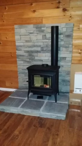

Here is a pic of the final product:

That Manchester certainly is a looker! >>
