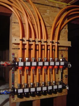

I went with a Mr. Pex, stainless, 8 port manifold with flow meters and balancing valves. I am sure any of the quality brands would serve you well.
