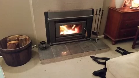

Hi, I have an insert in a brick wall and want to build a mantel above it. Just wondering if people can advise on best the height? I have researched and found figures range from 54 inches to 70. or about 1.3 m to 1.7m.
This is the only pic o have right now.

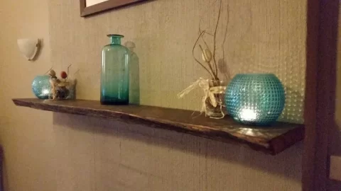

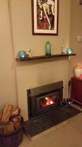

Here is the end result. Thanks everyone for your advice. FYI. I went with 600 MM above the top of the insert.

Interesting points. I was unsure of how much the mantel would heat up where it is. Monitored it all weekend and it actually stays quite cool. I was surprised. Thats the great thing about this forum. If it hadn't of worked for me, I still would have posted results so everyone else could learn from my mistakes. haha
