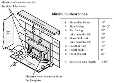

Thanks BG, I will have to get back to you with the mantel pic.The insert is a Lopi Freedom Bay. It doesn't meet the Letter "N" clearance.

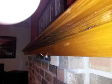

Here's a pic of my mantel. It might be hard to see since it's dark.

I was in a similar situation. What I did was to build up the Mantle at the supports to lift it into compliance.

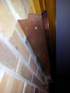

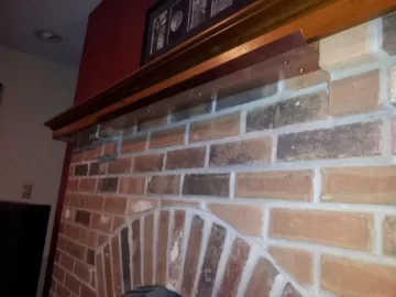

I had a mantle clearance issue as well. I had a piece of copper fabricated at a local metal fabricator and hung it below the wood mantel with ceramic spacers. can barely tell its there. I should have had it extend out probably another 3/4" though. The upper part of the mantel sticks out a little past the shield and get much warmer then the lower part as its not protected as much. Its warm to the touch but I wouldn't call it too hot to touch. I haven't measured it with an IR gun though.
The shield most definitely works though.

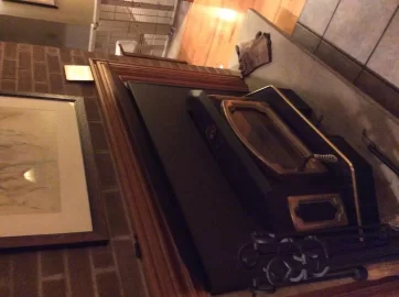

I have a freedom bay as well - I don't have a mantle but I do have trim that doesn't quite meet the clearances. The dealer installed a heat shield and it never gets overly hot. I will see if I have a picture.
Shawn
Mantle shield photo
Thanks for sharing your pic. The copper looks nice.
