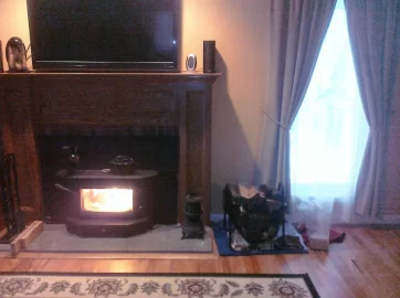

As with most things, this is an issue with many variables. My mount hasn't been an issue, its a 2010 era LCD, with a full motion mount.

No issues here for about 4 years. I can say that the top does collect a lot of dust, but otherwise no issues. Plus the TV is mounted right into the brick and that thing will never fall off.
