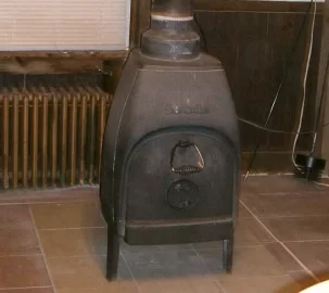

The odds are pretty slim, but maybe if you post the model or a picture someone will recognize it. I think in the long run you will have less permit and operational hassles by replacing the stove with a modern unit.
Below is a attached picture of the stove. Perhaps someone has papers, specs, installation manual or maybe know of the model it is.

Scandia stoves were low cost Taiwanese copies of Jotul stoves which appeared (and were the subject of a protracted law suit) during the first oil shock in the 70's. If I remember correctly, Scandia actually disassembled Jotul stoves and used the pieces as patterns for their own castings. They were generally regarded as poorly made stoves with inferior cast parts. They did, however, get a lot of people through a difficult time. I'd try going to the Jotul website and downloading the manual for the stove most similar in appearance to the Scandia you have. I would, however, leave a large margin for error with such things as clearances and operating temperatures.
HI,
Thank you for the info. I did go to the site but could not find similar. I did find the Jotul 1 model seems to be the same, but no luck on the site for a installation manual.
Your stove certainly seems to be a Jotul 1 clone. You can find a parts diagram for it at http://woodsmanspartsplus.com, but this is not the same as a manual. Emailing Jotul North America or a Jotul dealer near you might yield a manual, but there's no guarantee that the Scandia copy was an exact match.
