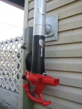

Mine goes up 5 ft.do blower thing In spring. EZPZ.
