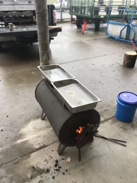

What do you use to cook yours down? I have done plenty of reading and been on pinterest looking up ideas but I always prefer to hear from people that know. I have an old water boiler tank (about 40gal) that has been converted into a wood stove. The Ag teacher and I are going to weld a place to put metal trays on the top and go from there.

Most start with steam trays over a block or barrel arch. I have a custom pan that I use over a masonry arch. Just make sure they’re stainless steel.
Started first cook down today. This will become a yearly thing.
