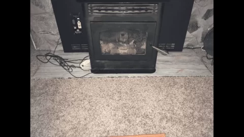

This is the insert that will be coming out. I was really hoping to be able to just cover the marble and carpet up with a hearth pad or something, but I don't know if that would fit code. If I have to cut and pull up some of the carpet, does it need bound or taped, or should I call the carpet installer? Sorry for the questions, I don't know much about what is correct. Thank you so much for your help!

The carpet will need to be cut back for the hearth extension. It doesn't need to be bound or taped.

The new insert will not protrude out as far as the old one, keep that in mind when figuring the extension. You may not need much if any at all, hard to tell in the photo.
