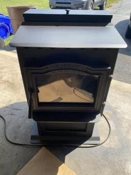

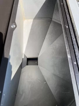

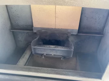

So I picked up a P43 on MP the other day for $300. Works perfect but needs some tlc. Gonna sand down and repaint. Already started the process.it’s a little rusty especially inside ash pan compartment. Any advice of how to remove it. Was gonna just wire wheel and brush it then repaint. But it’s close quarters.
That’s pretty much what I’ve done with the stoves I’ve refurbished, sandpaper and wirewheel, a dremel is great for the tight spots….Stovebright black satin looks great on them when it’s time to paint. Post some pics and keep us posted.
