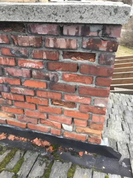

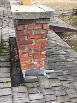

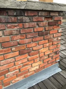

Ive got a chimney that's a little rough around the edges. I'd be interested to hear some opinions on whether its repairable or should be rebuilt. It appears to have at least three different sizes of bricks making it up. The cap is cracked and it looks like some previous attempt at repair is flaking off. Any thoughts welcome.

It looks like it's time for a rebuild. During the process, build a cricket on the up hill side of the chimney. This diverts water around it rather than dead ending into the bricks.

Yeah I agree there is not much there to repair.

Thanks. That's what my gut was telling me but I wanted to ask here. The roof is getting done this year so adding a cricket will be done too.

These bricks appear to me to be of a few different sizes. I've measured 7 3/4"x 3 3/4". 8"x 3 3/4". And 8 1/4"x 4". Is that amount of variance normal? In measuring and looking I've not determined rhyme nor reason as to why and where the differing sized bricks have been laid. They appear to be randomly slightly different throughout?

They are "reused" soft brick that I would not use outside.
I would replace with a sw, severe weather brick, with a concave or weathered joint.
An FBX brick has much less size size variants, than an FBS.

The reason they are different sizes is because they are called used brick. They used them on a lot of old buildings. Do you have these brick on your house? The reason is if you can build your chimney out of another kind of brick look at Belden brick they are a very hard brick last forever, look beautiful. Find something that will look great and stand the test of time. Remember a hard brick which is something that will not instantly suck the water out of the mortar, needed to be layed with stiffer mortar. To make the mortar stronger use silica sand instead of just regular mason sand. It costs more but for your little job it's worth it. To get the brick layed straight grab a very true 2 by4 and use that with your level when leveling instead of trying to slide you four foot level back and forth to line them up. As said above take your time no one is perfect have a mason ruler so you get the measurements for your dimensions lay a course around straighten with your level and 2x4 repeat till at the top. The key to laying brick is having the correct mortar, to wet brick slide everywhere. To stiff then you are beating them into place. You will be fine it's not rocket science trust me, see if you could get a buddy to help second set of hands comes in handy.

I wouldn't rebuild it. I only saw about a dozen brick that are bad. Just saw them out and replace.
Most of that chimney looks just fine, bricks are good and mortar is too.

With that many brick going bad there are going to be more failing soon. The reason is probably the deep cut mortar joints. Which would need to be cut back and repointed. So by the time you removed all of the bad brick took off the crown cut back the mortar repointed and poured a new crown on it you would have almost as much work in it as if you had rebuilt it and then you are bound to have more brick to replace in a few years. And you would still have the over sized head joints which are a weak spot. Yes it could be fixed but I don't see that it is worth it.
That chimney has been there for a while. I will bet that all the brick that are going to fail, have already failed.
These are probably antique brick. In the old days, some of the brick got fired properly, some of them were not fired right. They look good but are fragile.
In the winter, the bricks get wet in the rain, the next day it freezes, and chunks of the brick spall off.

I seriously doubt that I see it all the time we replace a few brick and come back in a few years and there are just as many bad as there where before. When we do that we tell the customer we can not guarantee more bricks will not fail because more often than not they will. Water has been getting into those brick for a long time and you may not be able to see it yet but I am sure there are more that are compromised.
Rebuild it once and be done with it, or piece it together and keep adding band aids to it over the coming years. I agree with a holler just do the whole thing and be done with it plus you said your doing the roof. I know I wouldn't want to get up on my new roof to fix my chimney that I pieced back just a couple years ago.
