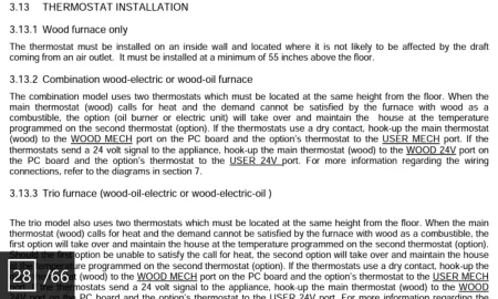

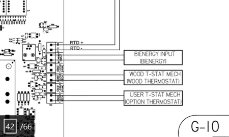

[Hearth.com] Max Caddy circuit board problem [Hearth.com] Max Caddy circuit board problem Here is how it should be wired and the diagram.

if that thermostat can use optional batteries you better off to just use the batteries and not use the common wire. If it doesn't use optional batteries than you will need a transformer to power it. Watch this video.
If the wood thermostat uses batteries it will be hooked up to wood mech, if it uses 24v common it will be hooked up to wood 24VaC. The oil burner will be hooked up to either user mech is battery or user 24VaC if 24v. I honestly don't know if you hurry the circuit board.

RH and W will go to User 24v. How are you powering the thermostat common wire?
Nevermind I see there is a 24VaC on the other side of the board.
Yeah I connected the R and C to the left side of the board at the 24V port. I ran the W wire to the top slot on the User T-stat mech. What should I have done differently?
c goes to left side of board 24VaC
r and w to right side of board to user 24VaC
it doesn't matter if r is on top or bottom as long as both are on user 24VaC
Just so we make sure we have it right, where is your r and w for your wood thermostat hooked up?

I think what I did that may have fried the board was I applied the W wire to the User T-stat port not the User T-Stat 24V port. I think I sent 24 volts where it shouldn't have gone.
When I hook the thermostat up with the C and R ports to the 24 volt connection on the left side of the board and the W up to the User T-stat 24V hookup on the right side of the board the thermostat calls for heat and shits down properly. The only problem is the oil burner does not respond to these requests and continues to run non-stop.
On the left side where the 24v is do you have the common in top or bottom? Take the r off there because it doesn't go there. Try each of the top and bottom with the common it if doesn't power the thermostat then hook it into one and put a jumper wire from one to the other.
