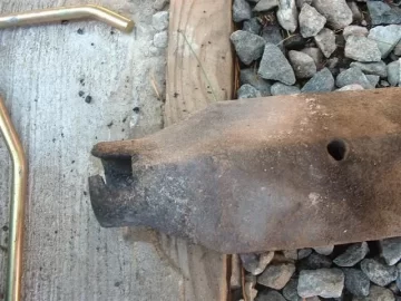

With respect to the aerator, mine will pop off the shaft after about a weeks worth of use and I have narrow the aerator to the jamming of the auger. When you install your aerator there is a key way to slide it over the shaft of the auger and then you match that up to the key on the shaft. You then turn the aerator to the right and lock it into place. After I do this and is when the problems begin. After about 3 +hours and coming up to temp, the auger will jam at the aerator. However if you put the aerator on the shaft and slide it onto the key and into the keyway of the aerator and do NOT lock it, and just leave it, I have found it will not jam. So, by not locking it onto the shaft, the auger will turn and within a week, as the pellets push out of the auger and over the shaft of the aerator, it works the aerator off the shaft untill it falls off.
So, now I wanted to see if that by locking it on the shaft another way, it could possibly fix this. I bought a second aerator and tapped it and put in a 1/4" cupped allen set screw and slid it over the shaft and onto the key. I did not turn it to lock it on. I then tightened the set screw a small amount. Just enough to hold it on. Within a couple of hours, the auger had locked up and my house was cold again. Next, I use my fire gloves and turn the aerator to the left and I notice the pellets all bunched just like before and I manage to free the auger. I then remove the set screw and put the aerator back on the auger shaft and DO NOT lock it on. The Maxim ran fine. So, today the rep is coming out to replace the auger and aerator b/c Cb thinks that the auger screw was not designed right and when the unit heats up, the expansion of the auger jams itself??? I only see a jamming issue when I lock the aerator on the keyway. If I do not lock it, it run okay and it falls off with a week.

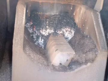

hear are the pics of the aerator in the burn pot on a weekly basis.

after I used up the last of the fireside ultras, I ran for a few days, then I got home from work one morning and found the fire out, and the auger jammed so bad it wouldn't turn until after I had pried on the aerator for quite a while. I called my dealer, he said it was most likly bad pellets. I figured this is just dodging stove problems, so I freed the auger, removed the burn pot, unplugged on wire to the upper auger motor, and ran all the pellets in the auger into a bucket. Sure enough I didn't have wet pellets, but I did have crumbly ones, those crumbles will jam the auger. I reassembled the stove and fired it up.
your post about the aerator got me thinking, since that night with the fire out I havn't had another one, I do find the motor trying to run and not turning quite often, if it goes for a while that way it will start turning on its own. when I hear the jam I open the door and pry on the aerator with the hook that comes with the stove, usualy that is all it takes. I havn't tried the loose aerator trick yet.

Call Stuart b/c the augers were manufactured wrong. And don't take no for an answer. CB needs to supply a new auger and aerator.

As for the auger turning problem, I found that pellets easily wedge between the aerator and the bottom of the burn pot, if the aerator stops with it wedged against a pellet it has trouble turning for the next cycle, then the pellet burns and it is no longer jammed (this only happens at the feed end of the burn pot, as the rest is coals and ashes) BUT now there are extra pellets in the drop from the upper to the lower auger (power failure burnback protection) THIS IS SOMETHING CB NEEDS TO FIX! lowering the burnpot or changing the shape of the wide edges of the aerator could help.
