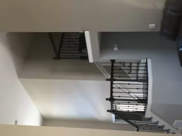

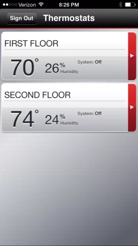

Yes, I'm definitely heating all 3300 square feet, without an issue. I will say that I have the perfect floor plan (it's VERY open) for a pellet stove (that wasn't the case in my last house). My house was built in 2005, so definitely a newer home. Not sure of the insulation R factor in my house, as I didn't build it, and haven't cared enough to go look :). The stove is in the corner of my family room (which has 20 foot ceilings). It faces the open staircase to the second floor, which really makes it the optimal location. Because of where the stove is, and the fact heat rises, it is always 2 to 4 degrees warmer on the second floor than the first floor. This was not the case in my last house where the stove was much further away from the staircase to the second floor. My Son's room (which is up the stairs, and around the corner) is the furthest away point from the stove, and is the "coldest" room in the house, and his room never drops below about 67 degrees. Here is a picture of my thermostat app showing the temperatures in my house last night, when it was VERY cold. You'll notice that on both thermostats, it reads "system off". That means both furnaces (one in the basement and one in the attic aren't even turned on)!
  • [Hearth.com] Maybe having a stove too big for the house isn't a bad idea
Very impressive! I am similar but doing 2,350 SQ FT currently. I am getting almost identical temps with my farthest bedroom on the second floor. My home is bigger than the 2,350 ft2 and I am almost ready to install the second stove in another area to open it up and supplement the 68.
I have been running around like a mad man with the IR gun and I may rethink my second install's location yet once again for the umpteenth time. I am amazed with what my P68 is doing and last night was a very good test. Thanks for your response! The original core two story here is circa 1984 but I have basically built another home around it. I also updated everything after I bought it in 2003. Still finishing some stuff since my place always comes last. Time and money. I pay as I go.
I believe your 3,300 SQ FT is the most I've seen so far being heated solely with one P68 or any stove for that matter. It's great to have a good example and another goal to shoot for. My issue is tons of glass and the non-typical custom place I've wound up with. Now ya have my head running in circles and smoke rolling out of my ears again. Thanks!!!!_g;lol;lol;ex I might get this other stove I bought 11/21 put in sometime this year.............

I wish I could take the credit, but truth be told, it really is all the floor plan. Don't get me wrong. The P68 is a BEAST of a stove. That said, if I didn't have the right floor plan, I probably wouldn't own a pellet stove, as I have no interest in having a cold house, and one room that is hotter than the sun _g. Luckily, in my house, there really is no way for the heat being put out by this thing to get trapped in one area, and not move. Here is a picture that I took with my back to the pellet stove to show how open the staircase is to the second floor. It truly becomes a "super highway" for transporting heat! Sorry about the sideways pictures. It's not sideways on my end, so not sure what happened when it got uploaded.
You held your phone vertically when you snapped the shot. Didn't you? Turn it horizontal and try that. Not sure what happens during the upload but it seems to change things. Still not 100% sure. If this holds true then maybe it can get put into the uploading photo details. Try it out.
Looks like a cool place and I have a similar open floor plan which definitely helps out. Your newer constructions is a plus also. Still pretty impressive IMO. Enjoy that heat and fortunate situation. Many, including myself, would like an ideal pellet stove layout. I'm not far off but have not taken the total plunge yet.
