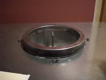

Hey,
The adapter on top does not have to be modified. It can be removed and replaced easily. See attached pic.
A new anchor from another chimney brand could just be screwed on in replace of the other, and then you could build up without sealing issues, without modifications.
In checking with a couple of installers, the opinion of a flue being "engineered to provide proper draft", is in the diameter of the pipe. The unit is a consant. If it is engineered to be used with an 8" ID flue then it doesn't really matter whose pipe it is. In other words there is not a lot of difference between Duravent and Security in so far as each provide 8"ID pipes for ZC fireplaces. In fact both of the installers provide the opinion Dura Tech is a better brand.
