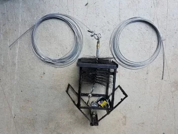

So I finally got my new mechanical chimney sweeper installed, its a bit more involved to operate it because it has two winches, one for up and one for down but I think it will be less problematic.
Here is an overview of the parts before installing it.
This is the pulley house assembly with cabling before installing it.

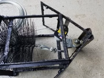

This is a closeup of the pulley house

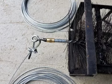

Closeup of how I connected cable to the threaded end of the brush.

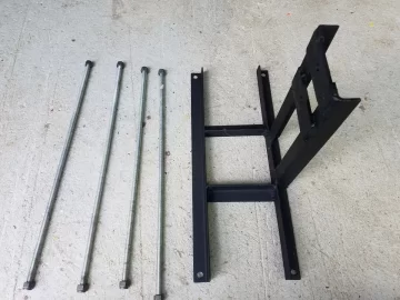

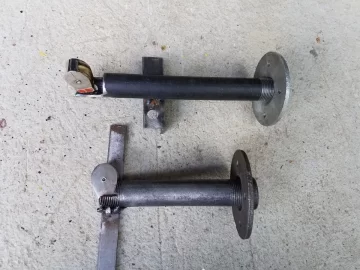

These are the shafts with pulleys at the end for the cables to turn up and into the chimney. One is short so the cable that pulls brush up runs along the wall. One of the issues I had before was the brush would twist and tangle the up and down cables.

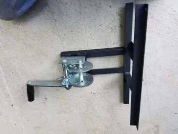

One of the two brackets that hold the winch to the side of the chimney.
[Hearth.com] Mechanical Chimney Sweeper finally broke but was worth it
Bracket with the winch on it

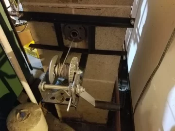

One of the winches installed, this one pulls the brush up, the winch on the other side of the chimney pulls the brush down.

Hi the doghouse in the first picture goes on top and stays there all the time. Its been there for years from the first setup. It does need to be run regularly to keep creosote from building up and locking the pulleys in place.
