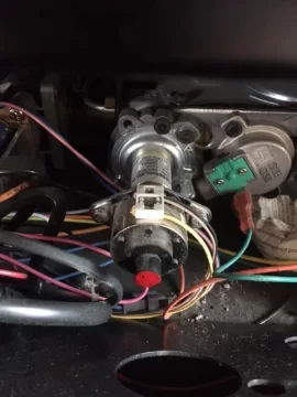

Can you post a pic of the gas valve? The term "piezo valve" is not familiar to me.
Steppers motors I'm familiar with & I've seen solenoids used for flame height
adjustment as well...
pos1234
Dec 21, 2020
4
MN
It’s a stepper motor. Not sure where I got piezo valve. Too much reading I think.
see attachment.

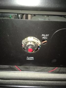

Take that cover off. Inspect the wires that go to the stepper motor for damage, they are delicate.
pos1234
Dec 21, 2020
4
MN
attached is the photo. I don't see any loose wires or anything else wrong with that stepper motor. At least externally.
