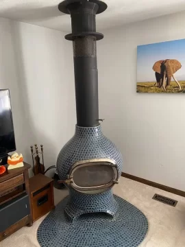

We have an early 1980s Meridian wood tile stove and would like to locate a blower for it. Any suggestions?
[Hearth.com] Meridian wood stove blower wanted
There is no blower designed or meant for this stove. It had a special connector pipe that convects heat quite well.

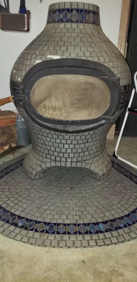

I was just offered one of these for free and Im still debating it, as They are heavyyy. But if you check the sell sheet BG it does mention a blower in the text, and also if you look at the diagram in the top right, it says something about when the blower is “on” the air pulls from top to bottom and when the blower is “off” it reveres flow. So I was actually curious about this as well since I havnt taken the drive to go look at this Merdian, Im curious to where the blower would go.
It looks like the blower pulls air down, which would place it lower. The picture shows it down in the base. And it is silent, unlike a magic heat, so I am thinking it may be a muffin fan.
Reactions: D. Hermit
The blower you are talking about was located at the bottom of the stove. The original models built in the late seventies used a horizontal shaft drive squirrel fan mounted in a custom built sheet metal box. They were really noisy at any speed capable of pulling air down the dual wall of the flue and stove. Later models were shipped without the fans and relied on natural convection to circulate air.

Local craigslist has one for sale . Beautiful stove and matching hearth.
But you can also see how the blower is set up with the pipe.
