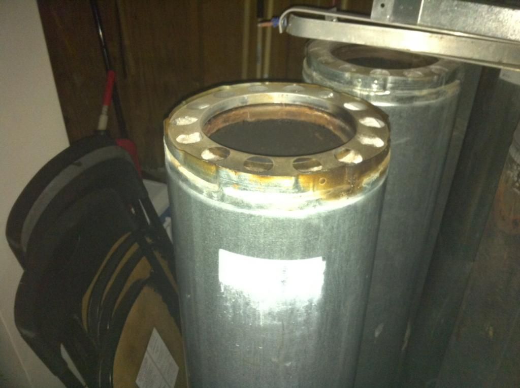

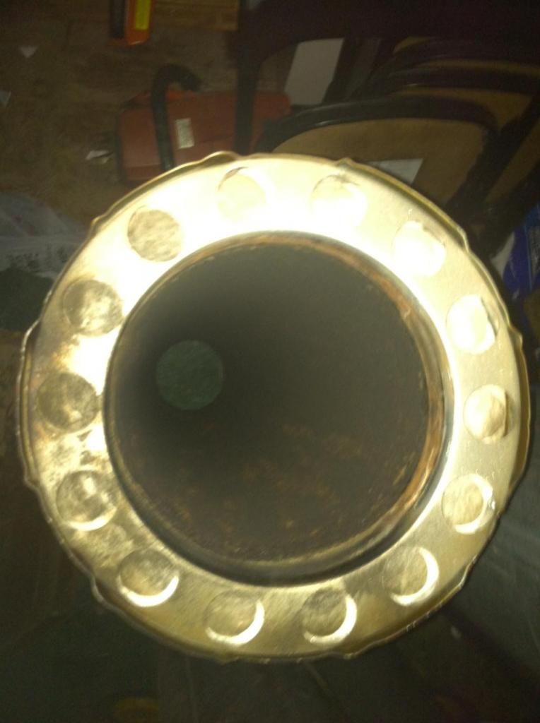

Hey guys, I just bought a NC30 off of CL for $600 which included over 24' chimney pipe, through the wall piece, and log rack. I had a few questions about the chimney. It had a sticker that was faded but I could make out Metal-fab. So I did a quick google search and found their website. It appears as though the chimney I have is
Temp Guard® 2100°. It is double walled chimney with insulation in between the 2 walls. Here are 2 pictures
[Hearth.com] Metal-Fab Chimney Questions
I just want to confirm this is Type A chimney and safe to use with a wood stove. Does anyone have any experience with this chimney manufacturer? Is this a quality chimney or should I sell this and look for another type? Thanks for your help.
Metal fab is good Class A pipe.
