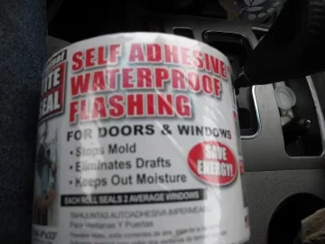

I found this @ Lowe's

I just need it to cover screw holes that fall were there not needed
