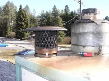

Some Pictures of My Chimney Inspection/Cleaning Today:
  • [Hearth.com] Mid-season chimney inspection/cleaning today

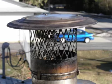

More Pictures

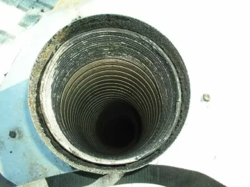

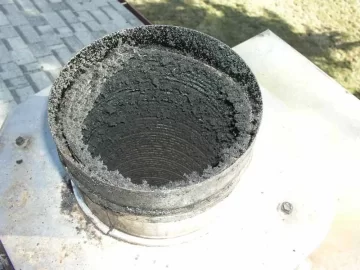

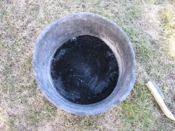

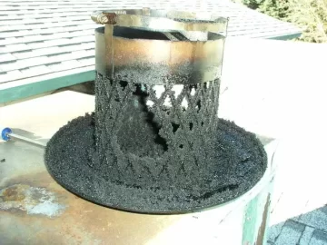

Picture of what came off the cap.
As usual, the chimney was clean about 1 to 1.5 foot down the pipe so I'm only getting cooling as the gas exits. This makes sense with how I insulated the pipe. About the last 10 inches of pipe is not insulated.
To note, this is about 9 weeks of burn time since the last chimney cap cleaning.

TM I don't know what you are burning but i cleaned mine beginning of DEC and again on FEB 10th
and i didn't have anything close to that. :ahhh:
Hmmm... looks pretty nasty. Is that liner insulated? You accumulation is the opposite of mine, that's why I'm wondering. The top 2/3 of mine was quite clean all the way to the topper.

Remember only the top 8 inches to 1 foot gets dirty like that. The rest of the chimney stays perfectly clean.
I'm burning a combination of Red Fir, and the last couple weeks a bit of pine I had leftover.
I also burn close to the condensation point for VOC's on my chimney quite a bit. I'm usually burning with a stack temp of 280-315. And the burning softwoods versus hardwoods doesn't help.
