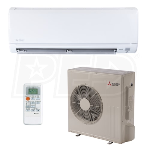

Yep, and the Mitsubishi I linked above is $2088. Hence my dilemma. Do I pay virtually the same, for what by all accounts is a far superior unit (both in reliability AND in performance), at the cost of having no warranty because of my DIY install ? I'm leaning towards "yes".Mr cool 24k is now 1900$.
THE top brand, two-ton, for right at $2K. Of course, this doesn't include the line-set and other installation parts![]()
Mitsubishi MZ-HM24NA - 24k BTU Cooling + Heating - HM-Series Wall Mounted Air Conditioning System - 20.0 SEER2
The Mitsubishi - 24k BTU Cooling + Heating - HM-Series Wall Mounted Air Conditioning System - 20.0 SEER2 MZ-HM24NA has been discontinued. Check out Expert's recommended alternatives for another top mini split system.www.ecomfort.com
