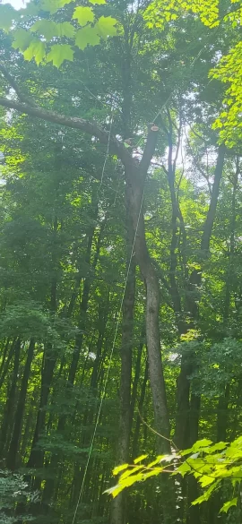

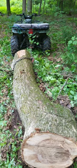

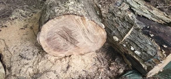

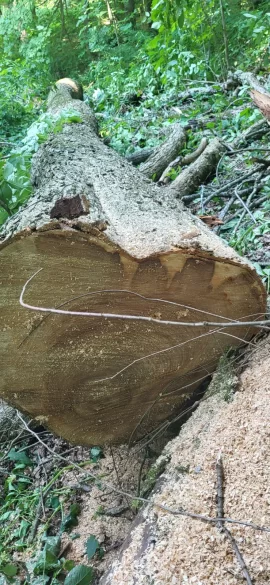

I had a 75 foot elm taken down a couple months ago it had to be climbed , see climber way up there I thought it was red elm,however when I started to cut it into manageable lengths I couldn't figure out how difficult it would be even with a chisel saw blade. I ran it by my arborist who works in the service department at the city I work in, he identified the tree as rock elm,and it is as hard as a rock,no other wood i've cut has worked a saw so hard, anyway its supposed to burn well so we'll get use of it red elm was simple compared to this.

You sure your chain didn't get dull very quickly? Those cuts and dust say that might be the case, while that big fat bottom cut showed a much cleaner cut and chips not dust.

Yes, it did. Then I went to a chisel chain, and it cut, but it was tough. I'm on my second Stihl chisel chain but I will get the entire tree cut into 18-inch lengths.

semi chisel should stay sharper for somewhat longer.
Just got to sharpen more and better.
The commercial stihl won't cut near as well as whatever saw u are using if it has a dull chain and your chain is sharp.
You can see by the chips their chain is sharp.
The dust around the other cut shows a very dull chain. That's just gonna fry your saw engine. And overheat your chain so it won't hold an edge anymore.

That actually happened i believe I got some mud on the chain that was attached to the tree after I dragged them to where I cut to lengths.

And there's your dinner. Dirt contact with chain makes instant dull chain.
