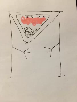

Don, you may want to wait for the unveiling of my new stove that $100 deposit will reserve your chance for the new Fisher Stove;
The Fishla, "Cyber Stove" ™ ready for production early 2050 !
Features will include 16 inches floor clearance making floor protection a thing of the past.
Lazer ignition, standard.
1/4 inch "30Z" stainless steel construction, a new high heat radiating alloy.
Thermocouple generator for high temp LED lighting.
Bottom auger ash removal system Big Bear Dump ®.
"Summer Mode" ™ top opens to grow your own firewood when installed in direct sunlight.
