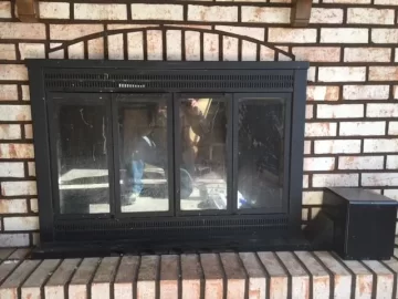

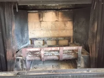

I have a traditional fireplace built in either 1979 when the home was built or in early 80's. It was modified by adding a blower system (image below).
[Hearth.com] Modernize[Hearth.com] Modernize
As you can see, this is not appealing. I plan on making the outside look like concrete using Cretewall and a gray color additive from Cretewall.

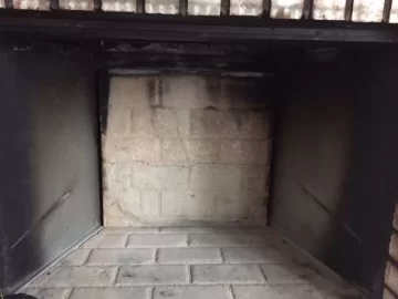

In this image I had to remove thin metal refraction panels on the left/right side. there is a hairline crack in the rear firebrick wall. Flooring is in fantastic condition.
