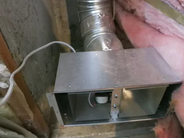

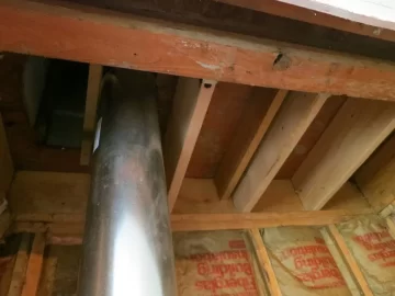

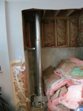

when we had our northstar ZC fireplace installed, we had heat zone kit installed and ducted straight down to the basement (8ft run).
in the basement, the duct comes in where an old fireplace box was installed, but that we had ripped out. the concrete foundation walls make a jog to fit the existing fireplace. originally, i had thought of just finishing off the wall flush with the other walls (removing the jog) and then having the heat zone duct vent through the wall. now, i'm thinking that it would be better to save the jog in the wall and frame it out for something else (bookshelves, etc).
my question is: how easy, or is it possible, to reconfigure the heat zone kit such that it acts as a ceiling supply vent?
see pics. ignore all the mess :)
thanks.

It'd be easy to relocate it up higher on the wall. Ceiling, not very easy at all. The vent will be most effective at room warming delivering heat low. Otherwise the heat may just stratify at the ceiling level.
PS: Was B-Vent pipe used for the ducting?
yes, i think b-vent is used for the duct.
i feel like it takes awhile for the length of the duct to heat up meaningfully enough to kick out warm air down low. perhaps if i spray foam it with CCF, when i do my basement insulation project, that might help. is that okay?
I've done something similar but I used roxul insulation. It's tested to 2100*F and it self just doesn't burn.
Sent from my Nexus 6 using Tapatalk
The venting should be B vent. Can easily take it apart and re configure it. I believe it has a 1 inch air clearance though so insulating it would void that.
Sent from my XT1080 using Tapatalk
