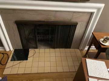

Moved in one year ago with an existing fireplace and caution from the previous owner not to use. Upon inspection I've discovered the chimney cap is shot, mortar between clay segments of the flu is missing, the firebox needs repointing. Started thinking of repairs when I came upon the 26% tax credit for efficient wood stove inserts. Made the decision easy, time to run a stainless flu through the clay and install the Ashford 25. I'd like to bump out the front a few inches, raise the insert 2 - 3" then add a proper hearth with correct R-value on the floor. Attached is a pic of my current situation. Thanks for your interest in helping me!

The buildout should be done with brick or other non-combustible. What are the dimensions of the current fireplace?
The raised hearth gets a bit more complex because of a few factors. The first is whether the fireplace lintel has to be raised if the hearth is raised.
Current granite surround is 58x35”. The fireplace is 42-1/4 x 26” depth at bottom is 19-1/2”, depth at top is 14-1/8”. I need 23-1/2” on height for the insert. Was thinking to use glue goo and fire brick to build up the base of firebox to match height on new hearth to get them both a few inches off the floor. If I bump out a few inches with fire brick, what must I use across the top to span the long dimension? Do I make a form, mortar brick then remove the form or should I use something else as a lintel?

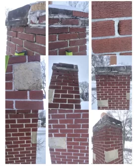

Thanks for the chimney concern. I’m already addressing this by removing the top 5 or 6 courses, relaying and replacing with a new crown. Now also considering adding the copper top I found advertised on this site. I’m so excited to get this operational to start burning again after missing all of last year. Im also super excited about the prospects of heating my home more efficiently with an insert.

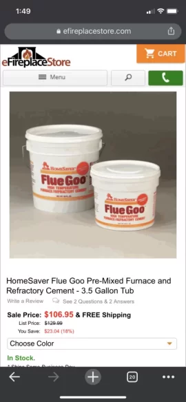

What is Flue Goo?

Flue Goo is a refractory cement I used to maintain the refractories in my previous prefab Superior fireplace. Come to find out Superior has been bought and sold multiple times and replacement parts for older models were no longer available. My old refractories look like Frankenstein, but all the cracks from years of hot fires are sealed. This product dries super hard and was easy to work with.

Ah refractory cement. It sounded like an ingredient for a Chinese dish, flue goo gai pan. :) I don't see a need for that in this project. I think firebrick mortar is more appropriate for the fireplace floor.
