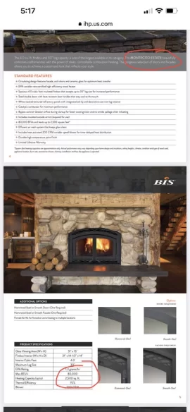

Thanks for sharing all this info!! I’m also trying to determine what zero clearance fireplace to install so this thread is helpful to read. I’m a bit confused though, I thought to be eligible for the tax credit, the HHV needed to be at least 75%. Where do you find that info for the Astria Montecito Estate? I’m only seeing ‘thermal efficiency’ as 70%. (I attached a screenshot of what I was able to find.) I’m guessing the ‘thermal efficiency’ term is a generic term. How do I find the HHV? Or perhaps my understanding of the tax credit is wrong?
Using your info from another thread, I think I found what you had looked at. Again, thanks for sharing all your expertise!

HHV is what is important. It's listed on the EPA website's spreadsheet as 79%.
Thank you!!
