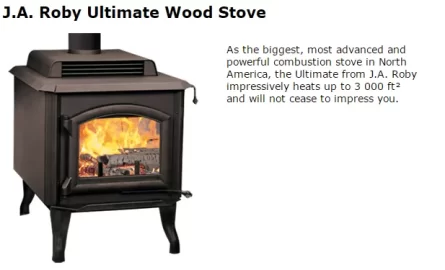

He's got a Roby Ultimate Dix. Not many seen here. It's a big honking steel stove.

I think the claim of biggest is overstated. Not sure about it's performance.
Reactions: Kevin Dolan
it's nothing spectacular technology wise,but it heats like a monster.this was my last hope for heating this place and it's doing the job but man do I need to buy wood it can hold 25 inch long wood i think i'll need at least 15 cords for one winter I find when I pack it tight n/s i can put whole tree in ;lol I plan on doing a review on it once i give a fair shake down.size wise i put in 5 bags of store bought wood at 1.7cubed per bag and it still had space

BTW, I looked at that stove when I was shopping for my 4 cu ft 'monster'. I remember the typo on their web site
Maximum output0 BTU/h
That kinda caught me ::P
it took us 2 years to finally buy it coudn't find one in the stores we were about to buy another stove when the sales person said they had one from same company in back to be delivered lo and behold same stove. so far happy with purchase need to buy a lot more wood it takes a lot to fill up 3 loads a day i figure 12 to 15 cords per season ;sick but warm;lol
