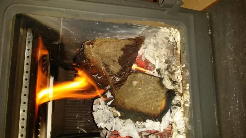

I find 8-16% works best for me. The dryer it is, the less air it needs to burn. Last 2 weeks, I've been burning wood that is at about 5-8%. Burns clean clean clean, and hot hot hot. The outgassing is beautiful, and I can burn with the air control just about all the way closed. Stove top temperature hovers in the 450-650* range for 5-6 hours.

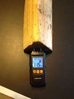

So I checked that batch again, and my meter was not on the correct mode setting. Correct setting was showing 8-13% when I rechecked this morning.
This is wood that has been inside for over 2 years. We try keep the RH at 45-55% in the home year round.

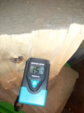

Cory, I'm sure that wood is great to burn, but you aren't getting a good reading like that. The best way to get an accurate reading is to split a piece of firewood and stick the prongs in the center of the fresh split. Not on the end. [Hearth.com] Moisture content in fire wood

I do that with my newer wood. When I split the old stuff and check it, it comes out within 1% of the splits I check on the ends :) This wood is 100% acclimated throughout. Also, if I get the prongs in deep enough, I do not get any variance in % even on fresh splits. (Maybe 1% again)..
