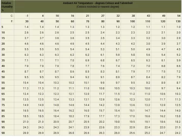

Here's an interesting study. Seems to suggest that without proper ventilation and/or a large volume of drying area to wood ratio, there are no gains using a solar kiln or greenhouse vs traditional split stacks. Good ventilation seems sort of like a no-brainer so good call on the fans.
(broken link removed to http://www.familyforests.org/research/documents/DryingFirewoodinKiln.pdf)
Also, 15-20%MC is pretty darn good and that's what I shoot for. Although its nice if it gets a bit lower but really it's somewhat unnecessary to strive for under 15%.
One other thing, I couldn't find the study I read before but I thought MC bottoms out somewhere around average relative humidity?
Edit: Found the chart: (broken link removed to http://www.woodworkerssource.com/moisture.php)

Yep, splitting wood is a no-brainer but regarding the test: both uncovered and covered stacks were unsplit similar sized rounds in order to compare deltas between the two.

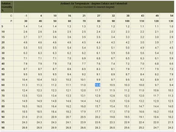

Higher humidity levels in the greenhouse relative to humidity levels outside will offset even a significant rise in temperature. This is pretty easy to extrapolate from the below chart, but if its 80F/50%RH outside then the EMC is 9.1. At 120F/60%RH then the EMC is 9.7, the wood would actually be taking on moisture even though its 40 degrees warmer due to the bump in relative humidity. Even with good ventilation to at least match outside RH (a large fan(s) running 24/7) it seems you would need some sort of additional dehumidification process in the greenhouse to actually see a benefit.
This is an interesting long-term experiment though. Could you measure the temp/humidity levels in the greenhouse at various times and compare them to outside temp/humidity levels?
EDIT: As PB pointed out below, I forgot to account for the drop in relative humidity as temp rises.
[Hearth.com] I built a 12.5' x 28' greenhouse to store and dry wood--working awesome.
  • [Hearth.com] I built a 12.5' x 28' greenhouse to store and dry wood--working awesome.
I believe you are missing one thing. A rise in temperature with air pressure and actual moisture content held constant causes the relative humidity to fall quite significantly. If you take 80 degree air at 50% RH and raise it to 120 degrees the RH falls to 15%. Then you let some moisture evaporate from your wood to raise the humidity. Your wood just got drier, that's where the additional humidity came from. Vent the humidity and the moisture is gone, permanently.
If you can get your greenhouse to gain 40 degrees along with a gain of 10% RH you have gassed off a good deal of water out of your wood. You are pretty much going to have dry wood wood in a matter of months. As long as you can jack up the temperature significantly I don't think that rapid ventilation is that important, and it becomes progressively less important as the wood gets drier because the will be less moisture to vent.
