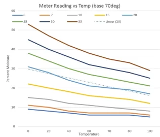

The line repeatedly goes that to get a good moisture content reading, you should bring it inside, warm to 70 degrees, then split to test. When out by the wood pile, the "warm the wood" aspect seems like a PITA, as opposed to just splitting it on the spot outside for testing. Anything wrong with just using one of the adjustment tables such as the attached pdf to correct for outside temperatures? (In my climate, add 4% as a conservative estimate.)
Then, to a lesser degree, there is the wood species effect (https://www.delmhorst.com/correction-tables#species) where, for example with alder, I'd add another percent or so.

The correlations seem fairly linear.
You should be able to test some pcs outside, then bring them inside to warm up and test again the same way.
Would be able to find out fairly quickly if the chart is worth using or not.

Thanks for the graph. Basically, as long as the wood isn't below 20 degrees, a 15 percent m.c. reading will suggest your likely under 20 in reality.
I thought about doing the experiment just for kicks, just haven't made the time considering the control for variables..same age wood, same dimensions, etc. I need to write down these ideas for when the kids get old enough to do science fair projects.
