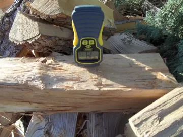

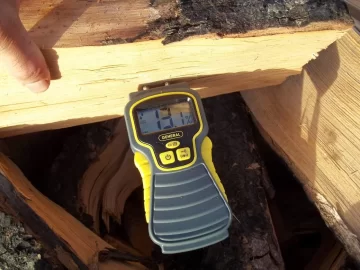

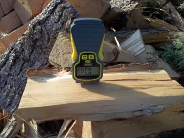

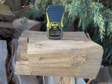

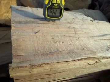

I just bought a general moisture meter from Lowe's (got idea from what I've read on here). I'm getting some readings below 10%. I guess that's good - maybe too dry. I tried 3 different species from the wood pile,
* cottonwood = 10.6%
[Hearth.com] Moisture Meter ok?
* lodgepole pine = 14.1%
* red elm = 9.6%
I have some quartered lodgepole and elm so I checked it, too. 13.1 on the pine and 14.9 on the elm.[Hearth.com] Moisture Meter ok?
These readings seem kind of low. This wood was gathered in the last year.The wood was all dead and this is a desert environment. I sold a few cords and have been throwing the elm off to the side because it was so much heavier than the other wood. I figured it was still moist. But, I guess not, even the large quartered pieces still needing to be split are only 15%.

Does your testing include re-splitting the wood before testing? Testing the weathered surface area won't tell you much about what is going on inside.
Did you resplit those pieces before measuring? The outside may be really dry but the inside is what matters.
Some of your measurements look like the outside of the wood instead of the inside of a fresh split.
Makes a huge difference. I've never seen a 9 on a MM.
I'll try to do some resplits and see what the MM reads. The lodgepole has a btu rating of about 21-22 for this area.
I checked some of my Ash this morning....16% on the outside....20% on a fresh split....some went as high as 23% on a fresh split....so you can go from something great, to something borderline in a hurry....and it's been in mostly sun for 8 months:oops:
Well, I checked the moisture of the above wood resplit. The quartered elm that was 14 on the outside was 25 and 40 on the inside (2 different pieces), but the firewood sized elm splits were around 10 on the inside (almost the same). The quartered lodgepole was 14 and 15 on the resplits (1-2% higher than the outside reading).
And I found some old unsplit ash and split it, it read 10.1. All of the firewood sized pieces were resplit and read. They were all about the same (6-12% moisture). In fact, the lodgepole was lower for a different piece I resplit (14.1 on the outside of first piece and 10.6 on a resplit different piece). I guess the desert, high elevation, and 100+F days are good for drying out firewood. I look north, south, east, and west and I see no trees just treeless land, and now I understand why.
