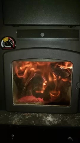

This is like 5 pieces of 20 plus year old red oak that all the pulpy stuff rotted off nothing is left but kind of petrified core. Bone dry. Alittle on the large size maybe 4x4. Put it in there about 3 hrs ago. I shut the stove down at 350. It went up in temp to 400 over the 3 hrs. Throwing a ton of heat still. I'm hot. Its 35 degrees outside and raining. Was 62 degrees in the house when I started my fire at 3pm and it was 44 degrees out and raining. Its 70 in the living room 74 in the basement with the stove. 1500 soft.

Here my load this morning. Stove was down to 150. Still had coals. Loaded wood at 550. Shut stove down at 610 when it was at 350 degrees.
