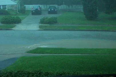

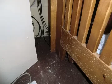

- Pics attached. Not even during that storm did I get one drop of water. Driveway is maybe 30-35% grade. House is above the street. everything flows down. I don't think there's a pool of water under my floor, but I do think you're right that it's saturated.
- Gas VC "Radiance" stove is not only for a dry-out tactic. It's COLD down there in the winter. HVAC sounds like a 777 at idle and it doesn't do much down there anyway. Gotta turn it off to make music. Hot summer nights I guess I won't be recording!

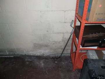

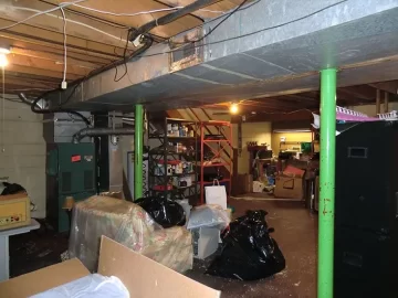

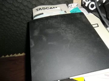

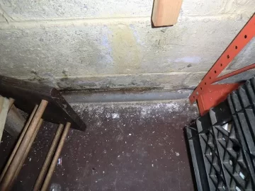

- As you can see, the walls are not covered with mold, but it's bad in a few spots and you can see it on the floor and on stuff. Some of what's on the walls is more old stains than real growth.

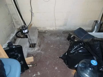

- Gotta cover the pump too. I don't think the pump is the real culprit here. It's the floor and its open perimeter.
- Radon system is working and showing negative pressure. When the gap is filled and sump covered it should be fine. I have a test kit. I'll use it after I seal everything up and see how it is. No use doing it now with all this work ahead of me. Sump pit used to have a plastic seal over it, very chincy. Was all shredded when we moved in. Think the bloody inspector would have said something!

Ok, that looks a bit less horrible than I think we had feared. You don't have 1000 sq ft of moldy drywall on the walls and ceiling!
Your logic above all makes great sense, and the floor and walls are reasonably mold resistant (concrete/block and paint).

The pictures of your block walls look like you have efflorescence not mold. If it looks powdery and minerally it might be that instead. This would also mean that you have moisture pushing/pressuring the foundation walls and could be a major source of moisture down there. Make sure your outside perimeter is not directing water to the foundation. Other than that, it looks like my basement, not that bad. Woodgeek has some good ideas.

agree with above, and based on pics, your basement is very wet and you have serious issues

No, you are 100% correct and that's what we did. I made the (mistake? wise decision?) of sending my wife a link to this thread, and she bought the dehumid within an hour of reading. It's a 50 pint DeLonghi, and it's been running non-stop down there, draining directly into the sump pump for about 3 weeks now. According to the humid indicator on the device's display, the humidity is now down to 50%, and I have the device set for 30 or 40%, can't remember which. Of course I also have a more accurate way of determining the humidity down there (a wet/dry thermometer) and it also has the advantage of being able to take a reading in a different spot. I may also have to buy a second dehumidifier, as the space is large and I don't want to mess around.
I still have to cap the sump pump, and I plan on doing that this weekend with a garbage can top, cut out where needed and glued to the floor around the pump. Last few weekends have been busy with tree work and I have been too tired to do anything after a full day of that in summer heat. **And also take a radon reading of the air.** I have the kit.
I recently had a conversation with a very knowledgeable guy who recommended a product to seal the floating slab. He said to buy a styrofoam "rope" product at the correct size, insert into the crack in the slab, push down below floor level about an inch, and then use self-leveling caulk to seal. You need an oversize, special gun because the caulk comes in a very large tube.
Funny, he was explaining it to me while we were walking in South Street Phila, and he looked down at the sidewalk and said, there, in that seam, that's what I'm talking about. Could be they use self-leveling fill in sidewalk seams too.
He reminded me to clean the inside top edge of the gap so the caulk gets a good bond. Of all the ideas I've heard, this seems like it can be done the quickest, and will not disrupt the way the foundation is handling it's union with the terrain. I'd hate to fill the floating slab gap with concrete, and then have water pissing into a basement which has been dry since the day we moved in!
