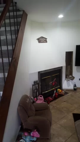

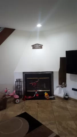

Hi everyone,
Second post but have found alot of advice and thoughts on other threads from here, so thank you to everyone posting.
I've decided to get a Flame monaco to replace and old Temco fireplace. I do have a perfect SS 8" class A Supervent (jsc) chimney, but have come to realize i will have to replace it all with a new class A 6" chimney. I have not found a way around it.
There was a thread pertaining to this but it was from awhile ago and I didnt see a clear winner when it comes to price and performance. Most of the hard work is done, like location of holes and such. Ill be installing myself, trying to keep costs down, the house we recently got has become somewhat of a small money pit for the first year.
Im pretty sure i will have to replace all the heat/floor/attic shields as i dont think i can use the same 8" id ones for a new 6"id chimney.
Any suggestions on the best 6" chimney to replace it with? God forbid i have to replace the fireplace in a few years, but i noticed the duratech seems to be compatable with a few more zc fireplaces than than the supervent jsc does.
Its a 2 1/2 story home built in the 80's, chimney runs interior with a 4-5 foot chimney chase on the roof. The 8" supervent jsc has great draft and no creosote build up when i cleaned it a few days ago.
Any advice or direction would be greatly appreciated. Thanks
Ps pics of current Temco added
