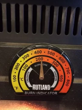

Do you have a burn indicator thermometer thing.

Yes oak is hooked up pellets seem to burn fine just lacking good heat??
