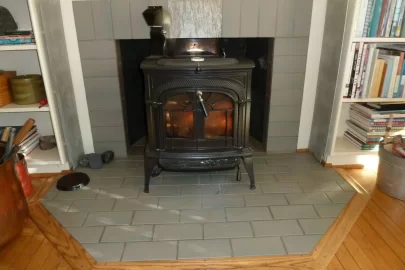

Hello, joined up just to pass along some of our complicated experience with our 2020 Intrepid Flexburn. Apologies if this should have been tagged to another thread, but these comments apply to topics on several different discussions. First, this is our 2nd catalytic Intrepid and these were both installed in a reworked fireplace . We removed extended hearth, removed fireplace damper and lined proper-height masonry chimney with a 6" solid stainless steel liner . Later added a directional (wind-vane) chimney cap to try to improve draft. We still have a larger flexible oval pipe section (with cleanout at bottom) to connect stove outlet (horizontal) to chimney that probably causes some eddies in the exhaust flow and a simple 6" elbow would probably be better.
We did not insulate around the SS liner but did a load of work here to make a safe, proper fireplace conversion (photo) and this worked fine with our previous Intrepid.
