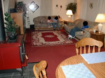

I heat my whole house with a PE summit and have never run my stove over the lower 1/3 air supply . I also do not over load the stove , two or three splits of wood is all it takes. This is also done with a 97,000 btu steel stove. Now i cant speak for the 30,000-55,000 btu stove owners. I would think the smaller stove would have to be run "HOT" or full / over loaded to do the same heating thus is why i bought the higher btu stove.
Dylan said:
Roo,
Perhaps you should describe your house....age?? size?? insulation?? ambient in which you live.
Dylan
Hi Dylan, 1800 sq ft , 2 story , 100+ year old house ( remodeled ) new blown ins in walls , blown ins in attic 12"-14". Live in Nebraska , in town. Front room and din room front of house with wood stove room size 16' X 29' ~ 464 sq ft , kitchen + den/living room + office + bathrooms back side of house. 3 beedroom & one den room upstairs. Our stove is in the middle of the house next to the stairs . stove is between front room and din room. *NOTE* to Dylan , actually ..... I'm SPIKE ~ Dan and my wife is ROO . LOL
