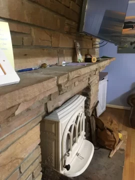

Running my F400 hard the bottom of the TV never got above 115. As you can see from the pic my setup isn’t perfect but could be worse. I’d get the extended warranty and a heat shield and flush mount tv to the wall. That said my father-in-law has stove 90 degrees to the side of the tv on a 34” buffet and there is always a perfect seat no matter how hot the fire is or and more important who wants the warmest seat. I would be hesitant to have a tv right above my freestanding stove.
How would you vent the stove. Some stoves like top vent better than a rear exit. Have you chosen a stove? Think about power and cable routing. I would install a power outlet near stove for eases of future upgrades or changes.
If I were to build a house I would find best place for the stove and the find the best place for the tv. Hope that is helpful
