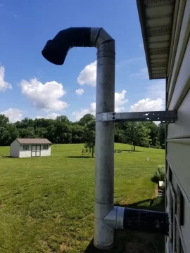

Appreciate the reply. Here is a pic of the outside run. It faces NW, the prevailing wind direction here. I clean it regularly. No issues, except flame dies and smokes when windy. Replaced lots of parts over the years, including blower a few years ago. Runs like a champ, when no wind. I can't help but think the wind creates the problem, and I need to get above the roof line. But I really don't know.

What diameter is the pipe and what brand is it?
And I can't tell what type of termination cap you have on it, if any. I guess a closer pic would help. Basically I am thinking the stove exhaust run is giving the exhaust blower motor too much resistance, so when the wind blows to a certain point, the blower motor can't overcome the added resistance value.

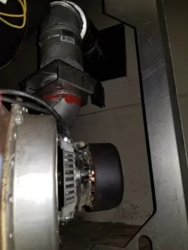

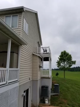

The pipe is 4 " duravent double walled. I have not tried opening a window. I habe tried many configurations of the outside run. I even built a run structure around it to try and shield the effects of the wind with no results. Tore the monstrosity down when it failed to achieve any results. Any thoughts on adding an open air kit? Thank you again. Jim.

As Vinny stated, opening the window has my vote. That should tell you if you need OAK. Opening window don't cost nothing. Might be a tight house. Based on the pics, I don't think EVL is an issue as you have 4".
My vote is for an outside air kit...
. . . and maybe a different end cap. I've never had good results with the type you have. I prefer the hood type. Oh yea, get the OAK.
I second the different end cap, get a hood type one and install an OAK. Be sure to update us this fall if you do these upgrades, I am curious the solution. Thanks.
I would run just straight out and put a cap on it like is on dryer vents, to block wind issues. And as others have stated, opening a window is an easy and cheap way to see if you need an oak. kap
I went straight out roof for that very reason. High winds all winter.
You should look into extending the vertical pipe 3' above that little roof and using a high wind cap like a standard furnace or hanging heater uses.
