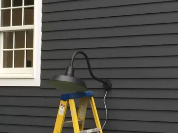

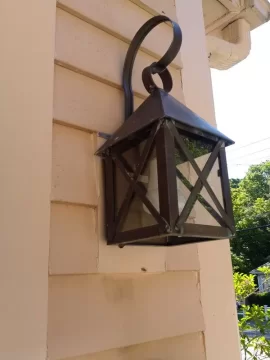

So, I have to mount these gooseneck lights on my barn, above each door:
[Hearth.com] Mounting wall light on clapboard siding [Hearth.com] Mounting wall light on clapboard siding [Hearth.com] Mounting wall light on clapboard siding
The mounting wall plate on the light fixture is 4-5/8" diameter, with mounting holes set for a 4" quad box.
I see a few options:
1. Hole saw a 5" hole in siding, and use same holesaw to cut a 5" slug of trim board to insert in hole. Then mount 4" quad box in plug.
2. Make up a surface block (or try to buy one?) to fit siding profile, and mount box in surface block.
3. Skip idea of mounting box IN wall, and just do a surface (eg. Red-Dot) box. Challenge will be shimming it plumb, on slope of beveled siding.
Ideas? Hoping to pick up required material Friday at lunch.

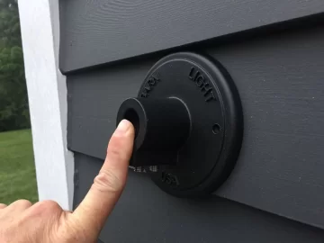

I don't see high probability in any of those vinyl things working on my cedar siding, but there's always a chance.

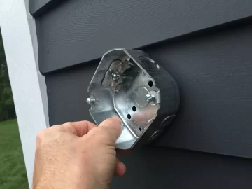

3/4 Pressure treated block with a pancake electrical box.
Let into siding, with hole saw or oscillating tool, or just mounted on surface?
I would go with the hole saw / trim board personally, will be a nice clean line as the base of the light is round. also as stated above the pancake box will only be about 3/4" deep, so it will fi in the trim board depth wise.
Cool. Sounds like a plan, the only possible exception being whether I can fit the wiring in a pancake box. The cover plate is flat, so no volume to use there. Might go with a 1.5" deep box... just because.

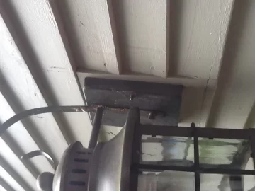

My first choice is as I described in a previous post with photo; using trim board mounted directly to the sheathing.
If that's overkill you can take a short section of the siding a little longer than the fixture base, flip it upside down, mount it to the siding and use your hole saw to drill through both pieces of siding. Install your pancake box in that. This creates a plumb (vertical) surface for mounting.
I really don't like the look or function of fixtures mounted directly to the non-vertical siding.
I actually missed that your trim board was applied on top of the siding, in that prior photo. I had thought it was let into the siding, and drip-edged on top.

you were right. It was let in and attached to studs.
Your cedar is painted, paint the block same color, and done.

I go for the flush mount, just did this on my house, used a 3/4 box, as fixture has only a 1/2 inch base depth.
6 or 8" pvc trim painted to match your clapboards. Clean look and won't rot

+1 you need to block out a mounting point with a piece of trim board.properly flashed and caulked.

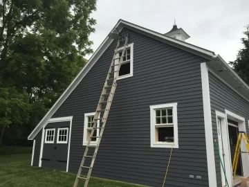

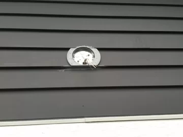

No worries, guys. It was all done on Saturday, with with cedar. I did the overlay with inset pancake box, in the end. Shown below in primer, they're all caulked and painted in, now.
Three lights, one in gable and other two over the doors.
