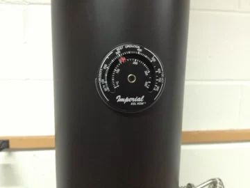

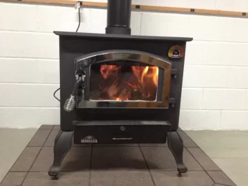

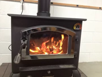

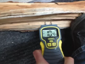

Damper is in... Just started a fire .. Load of just cherry at 10.5% [Hearth.com] Moved stove - problems with coals nowdamper is in open position, just turned the air control down on the stove, going to wait until the fire box heats good then damper quarter turn intervals[Hearth.com] Moved stove - problems with coals now[Hearth.com] Moved stove - problems with coals now

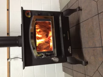

Threw a couple pieces in, I have full secondary's going and flipped the damper shut, maintaining my stack temp as in the first pic.. I closed the damper fully about 5 min ago, I'm noticing some good results so far, my fire seems to be calmer with lazier flames, girlfriend even said wow, looks like an upstairs fire Link Removedhardly any smoke coming out the chimney cap
Just a quick comparison. The 1st pic is yesterday's fire air fully closed on the stove box, no damper and here's today's fire air fully closed with a damper added to the first length of pipe coming out of the stove [Hearth.com] Moved stove - problems with coals now[Hearth.com] Moved stove - problems with coals nowthe velocity of the fire seems much slower than yesterday's... I will report tomorrow about the coal situation and let you all know if it improved or not
