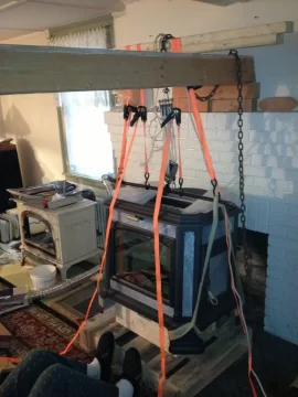

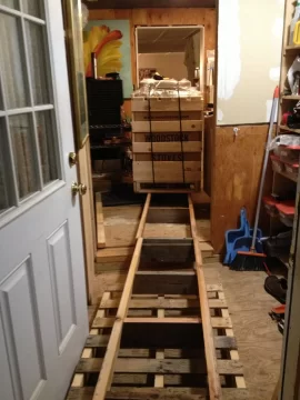

I had plenty of time to think about this since Woodstock had a production glitch and had to wait. I did this with my girlfriend and I. Made rails sligtly canted, waxed them up, Home Depot straps lifted and pushed in place. (My girlfriends legs pushing). 700 lbs is heavy I have to say. Why not a dolly? This house was built in 1850, the joists are, well let's just say NOT 16" on center and the joists run the direction of the rails.. The rails spread the load out.
