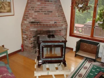

As far as moving it, If you can get it secured (bolted or strapped) to a pallet, and then use either some lengths of pipe (I'd use PVC - to avoid scratching the floor). You should be able to roll and turn it pretty easy. Just roll, and as one pipe frees up in the back, put that pipe up in the front and continue rolling. That should help avoid most of the heavy lifting.
Maybe this helps visualized what I tried to describe:
  • [Hearth.com] Moving a stove from one room to another
Too add to what Harley said build or get something that will keep the stove at or very near the level it is currently at.
Slide it over and then push/drag it to its final destination which, hopefully, will be at or near the same level (height)
Masonite is very slippery stuff, that and a little elbow grease (and human ingenuity) you can move mountains or in my case a near full 35 gallon fish tank on a stand ;)
