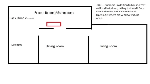

Is there something in market that you can fill your house with, to see how the air is being circulated? Or any ideas how this can be done?

Thank you for the info. Trying to get the most heat into the living room and location of fans, so far pushing cold air towards the stove isn't working much.

OK, that's a different issue, a blower door test is not going to tell you this. As noted in an earlier thread, the stove is not in the best location. Warming the living room in particular with will be hard due to the floorplan. The living room is isolated so it's hard to get a return air loop.

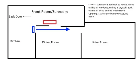

Have you tried a single box fan located here on the floor running on medium speed?
